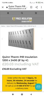

I am thinking of putting some thin say 15 or 20mm extruded polystyrene sheet with foil backing on the wall behind the fridge, to help keep it cooler when sunny.
All this is experimental, and I will post resultsScreenshot_2021-08-07-19-23-35-936_com.android.chrome.jpg
