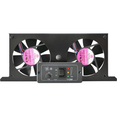

Has anyone used the fans that can be installed behind the fridge to aid air cooling circulation that many use in hotter climes and do they work?

I have used external fans in the top vent a few times and feel the do work, but I try to park with the fridge side in the shade this is why they are usually but not always on the side with the awning on.
PC fans are just as good if not better than the kits you can buy, and should pull air out at the top vent.

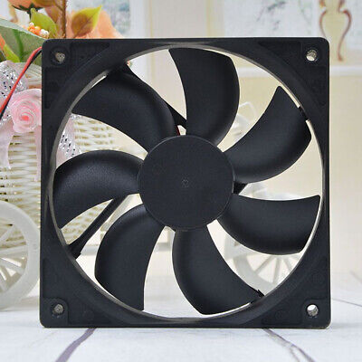

look at the first pic and you can see they're tied to a piece of 3 or 5mm ply a bit longer than the fans and screwed though that into the wood in the vent frame, this is on my self build, I can't find any better pictures, the fans are 12v PC, brushless and 100mm.

l fitted two old computer fans with a switch i simply glued the fan bodies to the back of the vent picked up a feed from the spotlights
One would also need a thermistor to turn them on when the going gets hot, and off when its cool.

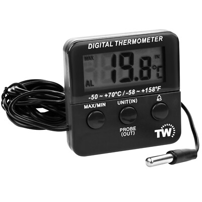

I had a temp gauge in the fridge with the display outside and a hi lo alarm so a rocker switch was all I needed.

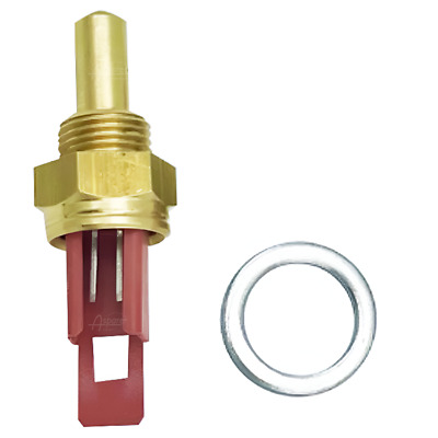

I'm too forgetful to remember that if it's hot, I have wired the fans to a switch, or if it's cold I need to turn the switch off. A cheap NTC from a gas boiler should auto regulate it.
(NTC is the common slang for Negative Temperature Coefficient, meaning that contrarily to normal laws of physics, the device reduces its resistance as the temperature rises)
Hence why I got a display with an alarm, I like to keep things as basic as possible and easy to replace or work around if things do go kaput.
This is the fridge thermometer I have in the fridge .

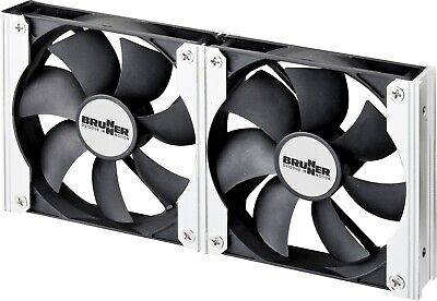

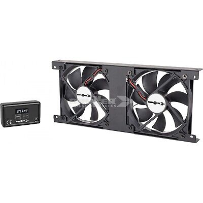

Or DIY with 2/3 of these, I had mine wired so I could have two or three running.
temp display with alarm
