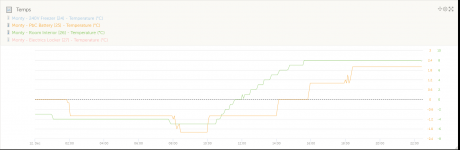

Had the heater on full power on the gas and while the temperature rose pretty fast from the initial -5C, it wouldn't go above an indicated 8C. Heater on the output limit and only just able to maintain a certain level?
Just went into van to turn off heater and it felt a fair bit warmer than 8C though. Probably was, but the temp sensor likely too close to outside wall and under reading. (need to double-check what gas supply it was using as well - Bit like having a hybrid Lead-Lithium Battery setup, I have a Gaslow-Calor Hybrid LPG supply. I thought I had the Gaslow turned off, as I wanted to use up the remnants of a near-empty bottle before using the refillable, but didn't think there would be enough to run the heater on full for nigh on 12 hours).
