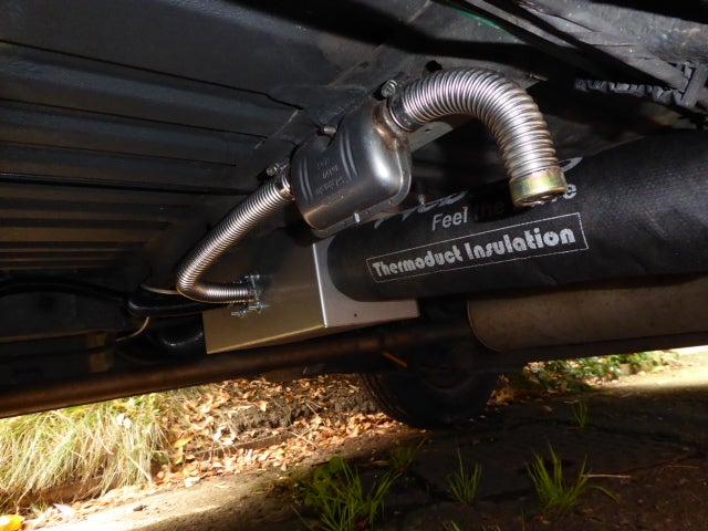

It's likely that my van is identical to yours, bar the badge, & here's how I fitted an MV Airo which has been faultless & I still love. Recently fitted an intake exhaust to make it even quieter (easy/cheap).
