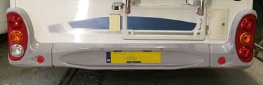

I would just ring the MOT station and offer to send a picture via email and go from there, if they say fail, maybe ring a couple of others are there are many jobsworths in MOT stations, for good reason, from your pic it looks lights are on the remaining bit, the only issue I see is possible jagged edges so some duct tape would make them safe.

Looking at the pic it would be sufficient for mot purposes to get a piece of aluminium sheet folded up in a c section and screw to existing ends . you could then mount a number plate . and suitable illumination . There is no structural standard to meet on this type of vehicle . HTSH .
The C profile is to ensure no sharp edges and to make it not likely to flap about .

Having replaced the lower rear moulding on my last coach built, I agree wholeheartedly with this suggestion. These things are not bumpers in the accepted sense. They have no ability to resist or absorb shock but merely act as prettily styled supports for the rear light clusters and to hide unsightly panel joints.
I would seriously consider RV2MAX's suggestion as a permanent fix. Plus ,have it painted to match.

It’s nothing more than a piece of trim and should be treated as such a couple of profiled upvc window boards bonded in place with pu40 would be more than sufficient to hang a number plate or trailer board on and could be made to look extremely neat. Far easier to diy than bending a sheet of alloy
if it needs to be grey then a good alternative would be composite decking it’s very strong and imho looks the part I used it cover the gaps where the tail lift on
