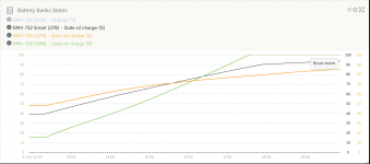

I plugged my Hybrid System into EHU yesterday as it was getting a bit low with 366Ah taken out the battery bank at the time I pulled the charger in.
178Ah of that came out of the Lithium, and 194Ah out of the Lead Carbon, so a fairly even balance in fact. However, by the time the Lithium had fully recharged (the straight green line), the Lead still had around 70Ah to go and took quite a few more hours to finish due to the charging characteristics of Lead Battery technology. If this was all Lead in the graph below, the Lead (orange) line would be a little different but not significantly so.
(for my own Hybrid system, the extended charge period of the Lead is not so important as it is rarely at a level when it needs recharging, so I am still taking almost 100% of the recharge advantage of Lithium in my mixed technology bank :) )
