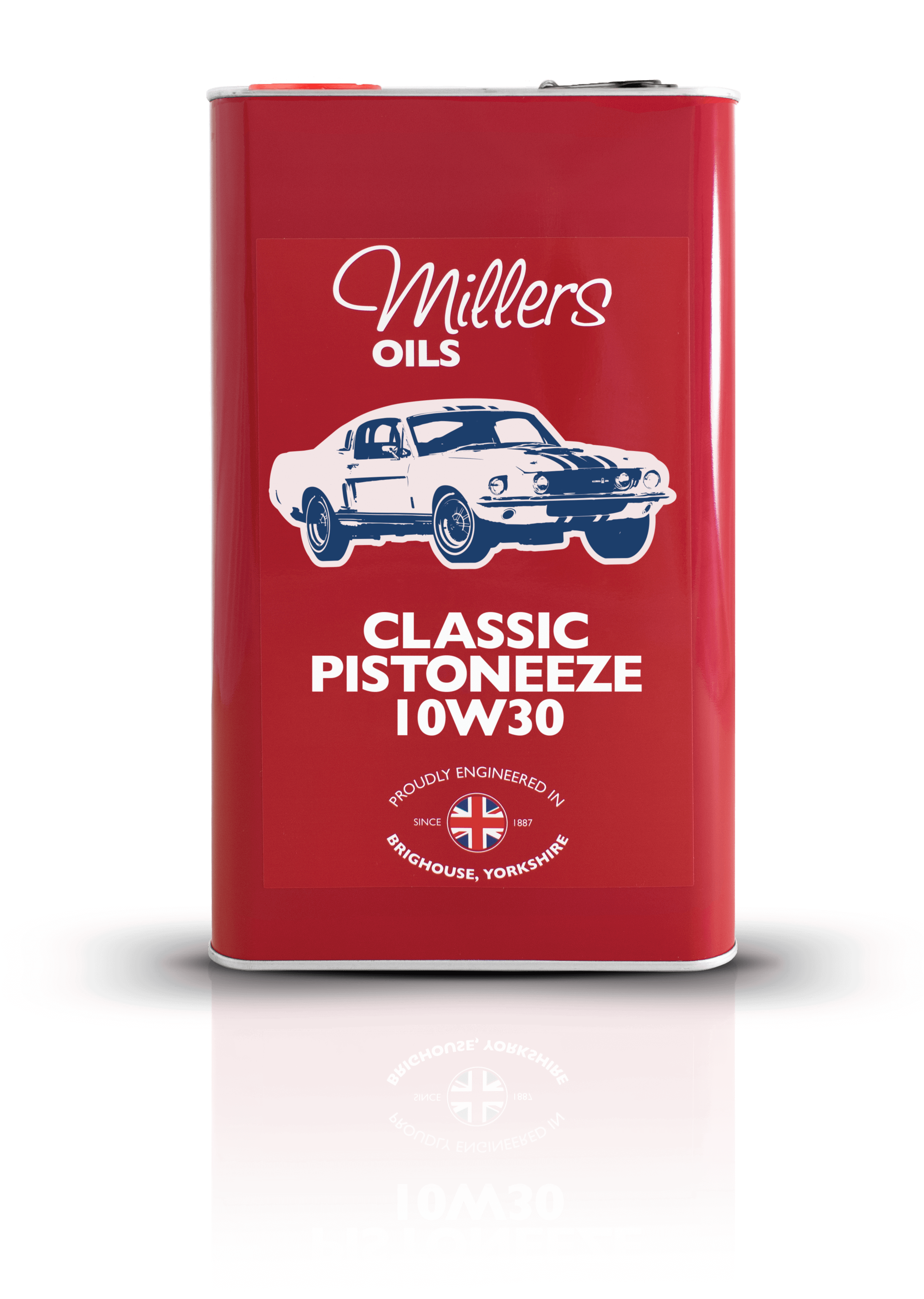

See this from Millers oils and in particular the features and benefits section... second para.
Not wanting to get into an argument, just saying...
As Einstein said " dont believe everything you read on the internet"
