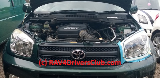

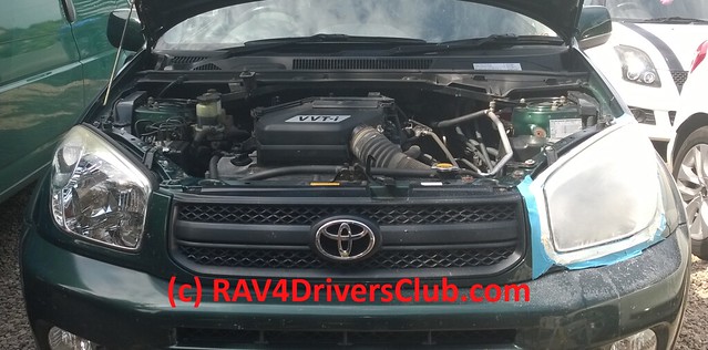

You generally need to remove the top surface as it is discoloured and there is no way to recover but needs removing. It can get a bit dramatic :oops:....
My RAV4
666Head-S1_Post_500-3 by David, on Flickr
But works out in the end (y)
666Head-S6_PlasticPolish-2 by David, on Flickr
