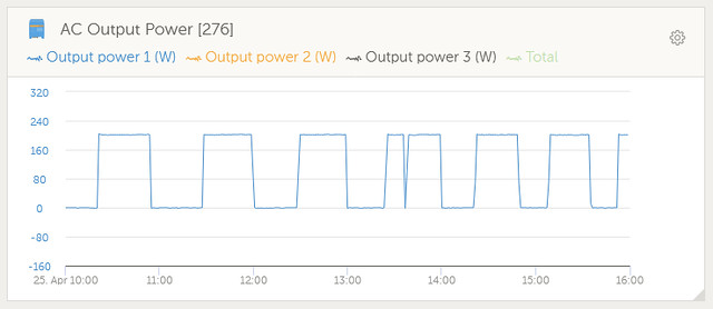

Duty Cycle of a typical 3-Way Fridge running on AC

3-Way - AC Daytime by David, on Flickr

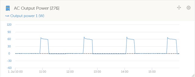

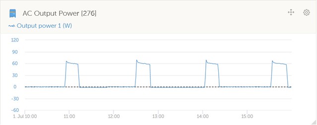

Duty cycle of Compressor Fridge for same time duration (10AM to 4PM)
Compressor Fridge - AC Daytime by David, on Flickr
So comparing the two fridges, you see when drawing power runnng on AC, the 3-Way is taking over 3 times the wattage of the Compressor Fridge

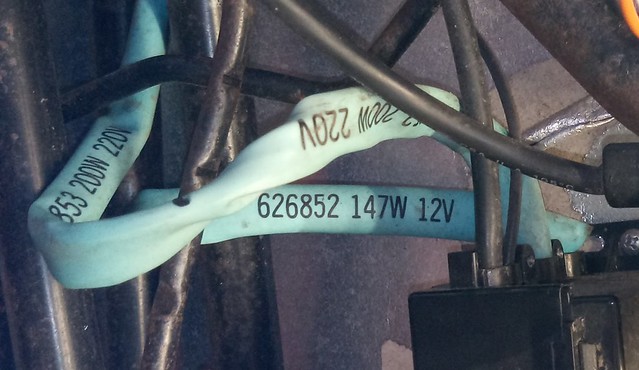

Maybe the newest 3-ways are 120W + 150W, but tend to be higher as per the photo below of mine.
Thetford 3-Way Electric Power by David, on Flickr
200W on AC vs around 55W for the Compressor Fridge.
Factor in the duty cycles and I calculated that the typical 3-Way Fridge used SEVEN times more power than a modern Compressor Fridge. And it doesn't matter if it is AC or DC for that difference. 240V Compressor Fridges actually tend to be slightly more efficient than 12C DC ones; include the inverter overhead and it switches around but either way very little to choose between 12V and 240V.
