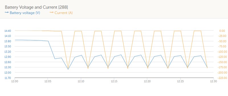

The Water Heater is setup that it is on a 60 second ON, 120 second OFF repeat cycle.
When the Heater is ON, there is a pull of 180A from the
battery for one minute. If we just take the
battery as a constant 12V for the purpose of the calculations, then each ON period means 3Ah taken out the batteries (180A/60)
From Cold, the heater is always on for over an hour to get to max temp, so I took the charts and after exactly 1 hour running (20 ON periods and 20 OFF periods), cross-referenced against the monitor provided SOC reading

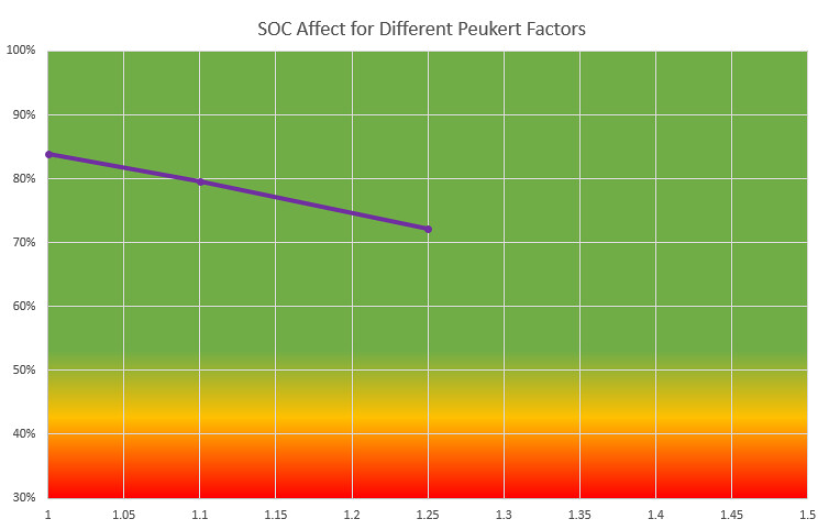

For Peukert Factor set at 1.25
Power Drawn is 20*3Ah = 60Ah
SOC is 72.2%
This gives the
Battery Bank as having a Effective Capacity of 216Ah - so 54Ah per
battery if we look at a per
battery view
The
Battery is quoted as 110Ah@C100 & 95Ah@C20, and would be 54Ah@C3.6 i.e. if you had a constant load of 15A it would last 3.6 Hours until totally depleted.
For Peukert Factor set at 1.1
SOC is 79.6%
Now this gives the
Battery Bank as having a Effective Capacity of 280Ah this time - so 70Ah per
battery view. A signficant difference.
The
Battery is quoted as 110Ah@C100 & 95Ah@C20, and this time would be 70Ah@C4.7 i.e. if you had this constant load of 15A it would last 4.7 Hours until totally depleted.
For Peukert Factor set at 1.0 (i.e. None). Now this one is purely calculated and I *think* you would see if you were setup for a Lithium
Battery config in the monitor.
The calculation would be:
The SOC with no Peukert Factor would be 84%
as there is no Peukert Factor the
battery would remain at 95@C6.3 i.e. with a constant load of 15A, the
battery would last 6.3 Hours until dead.

I will do one more run in next day or so with
BMV Peukert at 1.0 just as a final check against my calcuated version, and ultimately I think for my own setup I will be probably setting the Peukert Factor ABOVE 1.0 - but not to the 1.1
Victron recommend - maybe just 1.02 to account for heat losses and a nod to Wilhelm Peukert, who knew far more about batteries than I ever will
