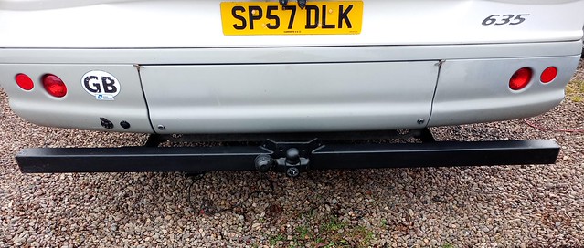

David, viewing attached image, looks like strengthening has been added to box and outrigger areas. One final possible option I can see from the images is to remove box from outriggers, remove the added metal from box and outriggers, new angle iron add to box section, with 2x holes on each angle. 2x holes drilled to each outrigger, which allows box section to attach to at the original position, and instead of 2x HTS bolts, when not towing, add one to bottom hole each side, top hole fit (don't know name) type of securing device you see on trucks to open/close side panels quickly and without keys required, I'm sure you know what I mean. The latter can be removed quickly, allowing box section to drop down and allow you access to rear storage. And if you require bar for towing purposes, top device removed, a HTS bolt added and all bolts torqued up fr towing. Nyloc nuts required of course.
Could you not cut off the brackets for the tow ball and fit removable tow ball .you would need a welder to attach receiver bracket.Screenshot_20230404_093831_eBay.jpg
I have a couple of small exterior lockers in my motorhome, but the only one of any size is at the back - but access is a bit compromised due to the towbar
Rear Locker and Towbar by David, on Flickr
The whole door has to be removed rather than just lifted up.

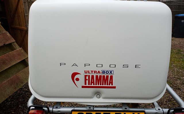

So enter the 'Papoose' (a Fiamma Ultrabox)
Papoose by David, on Flickr
But when I tried to put stuff in it, like the chairs, the blooming things don't fit :( Bang goes that plan :rolleyes:
