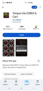

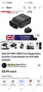

Typically my ODB2 reader doesn't have Peugeot, Fiat nor Renault listed and under "others" it still can't communicate with the van ( I know how it feels)
I have bought another from fleabay for less than a tenner, so it must be good, right? Anyway, this one lists Peugeot and fiat so will see how that goes.
K ;)
My new ODB2 reader says "NO CODES" and the MIL light never came on so maybe the egr valve is innocent?
