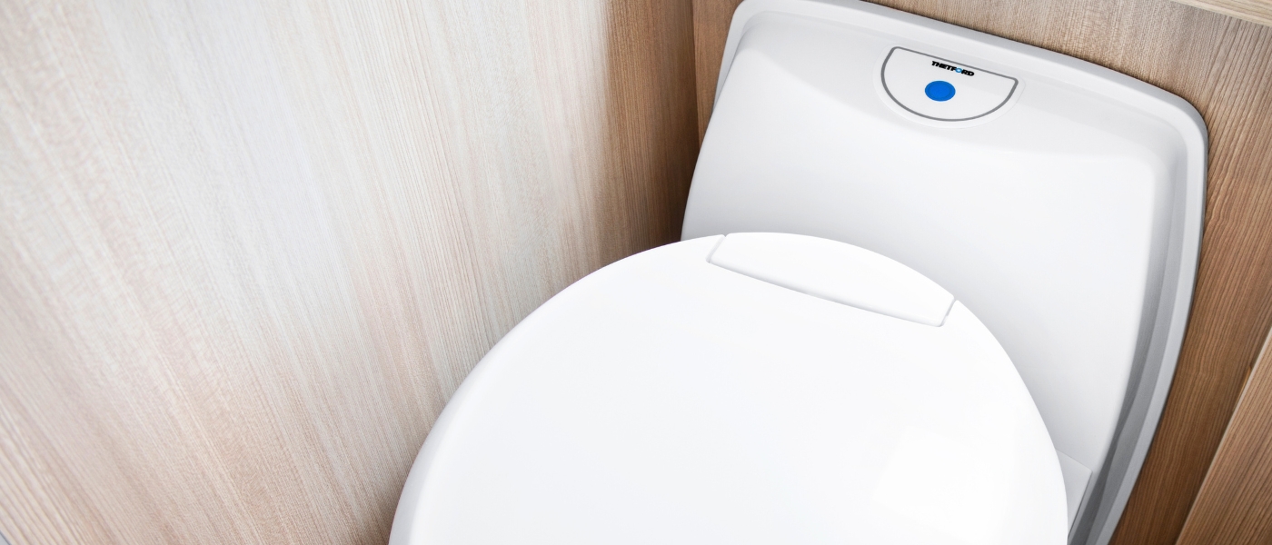

Elevate Your Caravan & Motorhome Experience with Thetford Cassette Toilets
The caravan and camper cassette toilet with removable waste-holding tank is the ideal solution if you are looking for the comfort of home, wherever you go.www.thetford-europe.com
