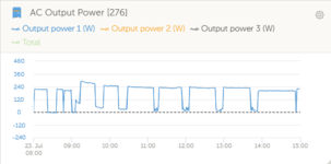

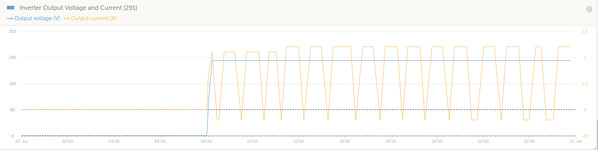

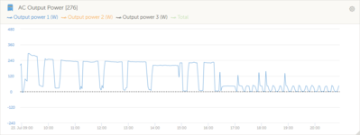

For electric, a little photo of the back ...
so meant to be 200W at 220V - which is why I am drawing 215W as my voltage is not 220V but 237V
and is 147W at 12V - so around 12.5A (to Thetfords credit, the cable they use for the 12V supply is very chunky - think it is 6mm2)
