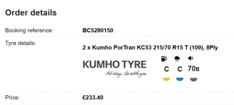

I got these.
No problems despite it being very wet on some of the twistier hilly bits & I would buy them again
No problem in Summer I put two new tyres on mine in April last year and did over 4k in France, my go to for tyres for a few years now is blackcircle.com unless you live on the moon they will have a fitter near you.
I got these.

I put my reg in just now and they didn't offer ANY 15'' sizes.

Tried that and it wouldnt let me.
