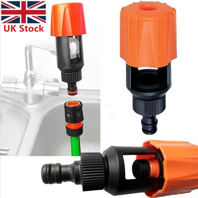

Not had this problem but in my array of adapters I have a rubber type fitting with a jubilee type clip operated by a thumb screw, so it does not push off.
There are many taps with a very short nozzle but that may work for some. I will have a look. Thanks.
