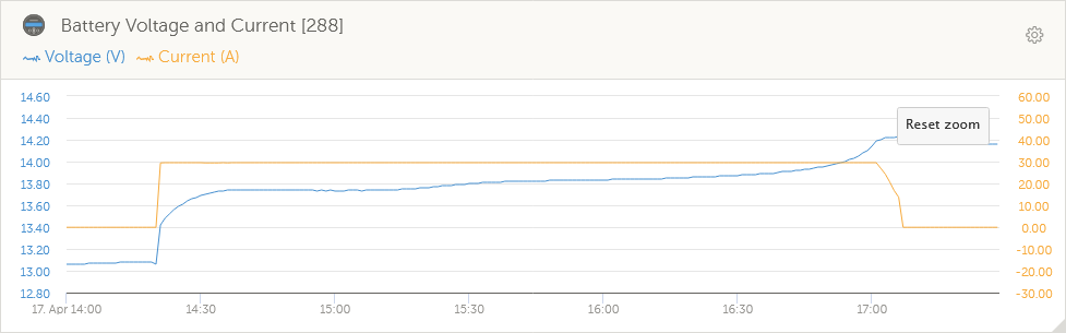

The current will be limited to whatever the charger can put out, but a key thing will be there will be no fluctuating input power like you would see on an alternator, so will in fact be a better indication of the actual battery charging characteristic and not skewed by a variable supply.
This is an example from a test I did a few years ago. This graph doesn't show the SOC unfortunately, but with a total of around 80Ah going into a 100Ah battery, you can imagine it started pretty low? Look at the current during the near 3 hours of charging using a 30A charger ... you would be hard pushed to find a more perfect flat line than that... a constant 30A from a 30A charger.
And that characteristic - taking as much charge as it can for the whole duration of the charge is why personally I am wary about charging a Lithium Battery, especially a large bank, via what is in essence a direct alternator connection with no limiting except from cabling and the alternator itself. IMO this is why it is such a bad idea to consider Lithium as "drop in replacements" on vans with low capacity split-charge systems as the stress potential is too large for comfort.
