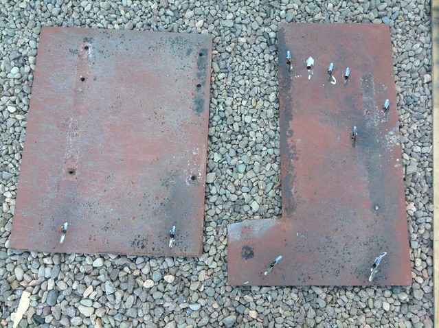

I totally agree the movano master low loader almost shouts "convert me" and for my next one I have been trying to decide whether to go that route or stick with the pvc option. The thing leading me back towards another pvc is that I want 2 travel seats in the rear for the grandkids, (probably on some unwin rails). In theory I can't see much difference between a box van and a coach built in terms of construction and safety but don't want to take a big risk. Anyone got any views / experience regarding this aspect please.
I can't see any reason why you cannot add unwin rails onto the floor of a box shell as long as they have appropriate underfloor strengthening plates.
I had a ex-motability VW T4 which had been adapted with some unwin rails and also a fixed extra seat. In that case the floor would have been too flimsy (they are normally only a single skin sheet) and very thick steel plates were fitted above and below the floor to provide a very strong floor.
This floor aspect often gets ignored and there are people out there who just bolt down seats to the thin single sheet floor of a panel van and add no strengthing at all. I don't know about the ducato vans but if you were to look at VW T5s, there are two different floors - one for the panel vans, and one for the versions with rear seating (Shuttles, Caravelles and Kombis) which have strengthed floors out the factory. VW also do a 'hybrid' version - a Panel Van but with the strengthened floor that is specifically designed for - and only sold to registered - campervan converters.
Good Seat Makers, such as the company that make the very good RIB Seat produce a special underchassis mounting frame to make it as safe as possible.

And some plates that the seats were fixed to
Versa_2 by David, on Flickr
(there was additional plates underneath as well not in this photo)
