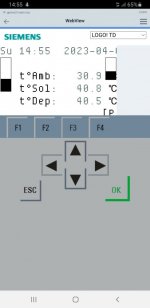

Back on track :). As anyone can see, by hobby is an extension of my job and what good is your skills and knowledge if you don't apply it. That being said, my electrical system is controlled by 2 simple Siemens Logo smart relays with a display panel that are networked and connected to a 4G router. Everything is controlled by these 2 simple PLC's (Programmable Logic Controllers). In addition I made some laser cut panels to install various instruments to monitor the systems. I have a 230V powered battery charger that I can connect to shore power mainly to keep the van's battery topped up during long periods of inactivity. The camper batteries can be completely switched off with a main switch but it's not wise to do the same with the van battery. The "control zone" is mounted on the trim panel above the sliding door and include the battery charger control which includes the step monitor and external power cable connected (an alarm is sounded if I start the van with this cable connected even without power or the step in the out position), solar regulator remote display, AC and DC power monitors and the PLC display. There is a whole lot of wires to connect all these systems.

When I press the power up button, a certain sequence must happen to avoid damages. The PLC is powered up and the battery voltage measured and if ok, the sequence begins. The main power relay is energized first. It's important that the solar charger is connected to the batteries before the solar panel so, it's relay does this and then the solar, pumps in sequence, fridge and so on with the inverter connected last. All systems can be individually activated and deactivated by the PLC control panel. The PLC also monitors the van door lock/unlock condition and I'm able to do this remotely through my phone. When the van is started, the alternator voltage is checked and if necessary, the camper batteries are also connected to the alternator.

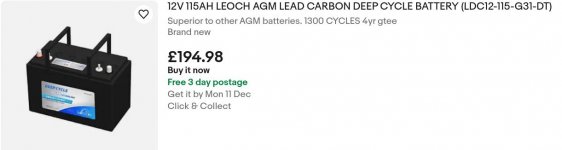

Lead carbons are the way to go, van is a good job health to ware.
