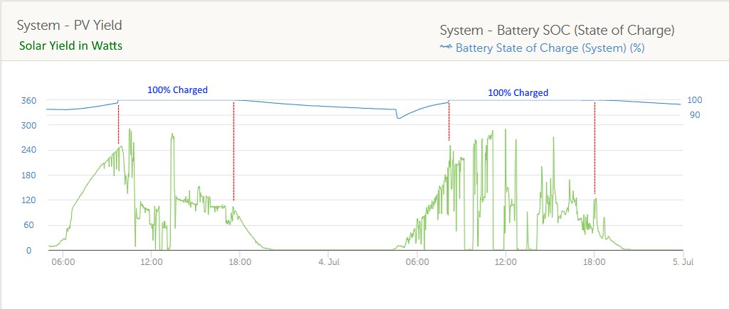

For my 400W installation I see this information (in the summertime)
Solar Yield & SOC
by David, on Flickr
Most of the solar harvesting between the start and finish red lines each day is just wasted (it is evident by not even being there! There would be a nice curve from morning to evening if all the energy was being ustilised). I'll be using the BMV Relay output to automatically turn my hot water on as soon as the batteries hit 99% SOC and then off again when it drops a few percent. Found the principle works very well on my testing in the last few months :)
