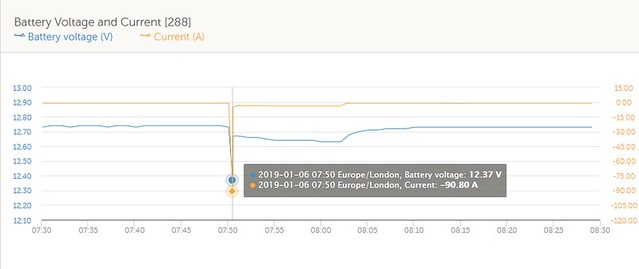

Wildebus - did you try running your fridge from a 375VA Phoenix inverter, or are you just guessing it won't run it, or allowing a safety margin? The peak your fridge drew was around 5-600 watts. The peak for the 12/500 is 900, for the 12/375 is 700, so I wonder if it would do it. It's only that high for a very short time.
Ah, for anyone else, he's already covered that. According to his Victron info, peak was more like 90 amps. That doesn't show in the video on his fridge thread. He did try the smaller model inverters and they didn't work.
The fridge failed to start with the 375VA Inverter just as it failed with the 250VA Inverter.
I was able to get more accurate info on peak current draw as my equipment changed and I saw the peak was greater than 600W. I have more information on this blog post - https://www.wildebus.com/blog/products/selecting-the-right-inverter-for-an-ac-fridge/

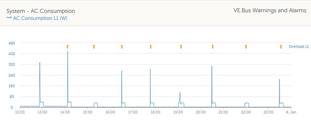

See the graph below for a 800VA Multiplus
MP800-FridgeACvsOverload
by David, on Flickr
Now bear in mind a characteristic of the way the data is sampled means that the peaks are not always captured (the data is sampled just once a minute; the peaks only last 1-2 seconds), but the overload situation is noted every time on an inverter that can run at upto 650W continuously.
Is the fact the inverter goes into Overload an issue? not if it is designed that way. From Victron ...
“Full bursts – High Peak output
Some electronic devices – particularly those which have an electric motor – require short burst of energy on start-up which is much higher than their rated power consumption. No problem – the Phoenix inverter has industry-leading peak-power capability.”
That peak-power capability is delivered in an 'overload' condition.

Have you ever tried an inverter that has a normal load rating big enough to handle the fridge peak load to see if it doesn't make the 'overload hum'? A 12/1200, getting expensive - £327 over here, and heavy at 8kg!
