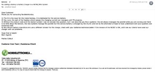

I had considered putting the B2B in the line between the Starter Battery and the Nord's J1 connection, this could be fine with a 30 Amp B2B but would the PCB survive with a 60 Amp B2B and Lithium? Also if RE1 opened how does a B2B respond when the path to the battery it's charging is suddenly removed?
@Philip Tomlinson .
Hi, I came across this thread via a Google search. I'm currently researching adding a B2B to my Dreamer D55 which has the Nordelettronica NE196 and am planning to install a Sterling BB1230 between the starter battery and J1 along with a Sterling 100Ah lithium battery. I was also concerned about the current capacity of the NE196 and so I emailed Nordelettronica customer support. They sent me the attached reply, confirming that the capacity of the circuit around J1 and J2 is 70 amps, so I would be comfortable with my choice, but you may have concerns if you are installing a 60amp B2B.
