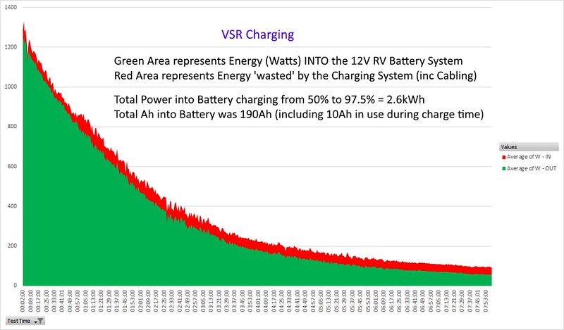

Here is a nice colourful graph in the meantime of using a VSR:
BT - VSR Excel Chart
The Total of the Red Area and Green Area together is the power that was generated by the power supply to the VSR e.g. the Alternator
The Green Area is the power that actually went into the batteries as recorded by the system.
The Red Area represents the power that is lost within the cables from Power Supply to VSR, cables from VSR to Batteries, plus of course the VSR itself.
Doing the maths, this means there seems to be around 12.5% power losses between supply and battery - that is a fair bit for a fairly basic Relay, but there is bound to be some as the relay got pretty warm as did the cables and of course heat = wasted energy in the charging process.

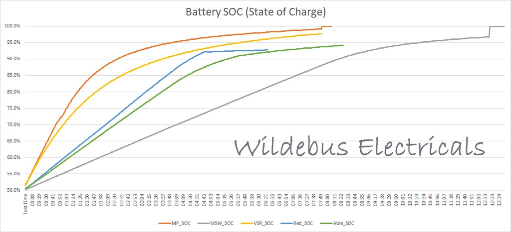

Well this is a graph of the 5 different charging tests carried out showing how the SOC (State of Charge) increased over time for each of them and how long it took
BT - Summary SOC
As you would except, the Multiplus in native mode (the RED line) is the best performing device. But even this unit still takes nearly 8 hours to fully recharge a 380AH Battery Bank from 50% SOC.
The next best method is actually the VSR. This tracks the Multiplus quite well, but is not as effective because there are losses in the Relay and cabling, plus the maximum voltage is 0.5V lower.
This lower voltage will prevent the battery ever getting a full charge BUT the increased current would make up for that (there is a gotcha about this later on). So for MY setup, the most effective option would appear to be the basic VSR option rather than B2Bs costing hundreds of pounds!
The two B2Bs start to close the gap but not until 4:30 Hours later.
What I saw and I am not sure if it is commonly known is both B2Bs (which are different makes)appeared to switch to Float mode after a set length of time - 4:30 in the case of the Redarc and 5:30 for the Ablemail. This is before Charging was complete.
In the case of the Redarc, the float voltage went down to around 13.2V - this level is actually not enough to provide any charge (which is why the blue line just flattens until I stopped the test). The Ablemail float voltage was 13.8V, which is similar to the alternator output. The effect is that charging continues at a reduced rate and the SOC increase slows of course.
Finally the 20A Charger + Inverter is a good steady line and eventually provides a full charge, but being only 20A takes quite a while

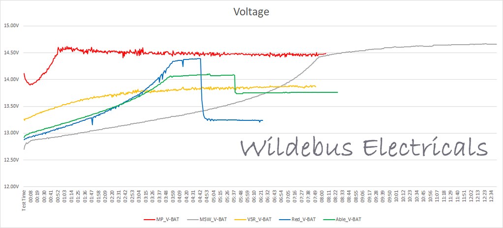

This is what the voltage outputs look like for the different chargers
BT - Summary Voltage
Shows quite a variety of approaches here
The initial voltage levels are down to the current going in so the voltages are gradually going up while the (smart) chargers are in bulk mode.
The Victron Chargers (this includes the Inverter test) go up to over 14.5V as they have temperature compensation available.
The Redarc goes up to 14.4V (the basic target for Lead Acid) before dropping to a surprisingly low 13.2V float
The Ablemail goes up to 14.1V before dropping to 13.8V for float

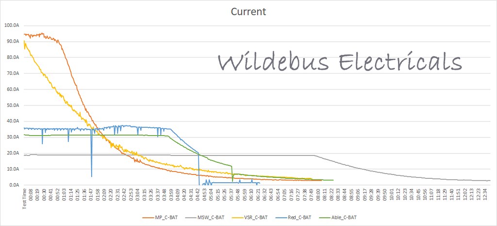

The choice of what capacity charger to go for depends of how large a battery bank you have and how quick a recharge you need
As can be seen from the Graphs, the 20A charger will take twice as long as the 40A charger to get to Absorption mode but will not take twice as long to fully recharge. As an extreme example, the 20A charger is nominally just around 20% of the capacity of the 95A Mains Charger, but actually completes its charge from 50% to full in just over 70% extra time in my testing (12:30 hours instead of 7:50 hours)
As a point to note, the data I am seeing and from the conversations I have had with B2B manufacturers, you can reckon that for the typical 30A B2B Charger, it will take around 1Hr per 100Ah to go from 50% SOC to completing the bulk charge.
Once the charger goes into Absorption mode, the current starts to drop fairly fast and the actual current capability of the charger becomes much less of a factor.
When selecting the charger, also bear in mind the basic rule of Lead Acid Batteries - you should typically charge at no faster a rate then 0.2C e.g. A maximum of 20A per 100A of battery. Some people and some battery makers recommend 0.1C (10A per 100Ah). My own batteries happen to be ok for 0.25C which is why I set my Multiplus for 95A (0.25C of 380Ah).
So if you have 200Ah of Lead Acid Batteries, you probably want a charger no greater than 40A maximum output for example. You won't see 95A going into the battery for more then a couple of minutes at the most (unlike in my example) with just 200Ah and you would run the risk of excessic charge rate as well. In this case, the case for a B2B over a VSR is much more convincing.
For this reason on Maximum Charge Rates, the opportunity for getting the full usage of a B2B like a CTEK with SmartPass (to give a 100A capability) for the typical Motorhome Battery Bank is very limited I would say.
This chart shows the Current delivery of the different chargers to help illustrate what I am meaning
BT - Summary Current

I double-checked the logged test data for the Redarc - it actually went to 13.25V when it went to float. The specs say it should have gone to 13.3V. It does seem a bit low to me.
Redarc make a Lithium compatible version of the B2B. In that version, when set to Li (lithium), float is 13.6V, but the non-Li settings are still 13.3V.
There will be a reason for the low float setting I would think. I am in conversation with Redarc to understand the chargers operation in better detail.
Just talking about voltages, I also mentioned the Ablemail only goes to 14.1V? this is the current default and has been deliberately set to be a safe level for any battery. It can be programmed by the factory to a different level though I've have a few conversations with Ablemail and they are looking into the options in this area.
Sorry I mean the temperature sensor on the battery not the B2B. Mine shows a lower charge plane if no TS is fitted, I would guess it just senses a wire though to say if one is fitted.
