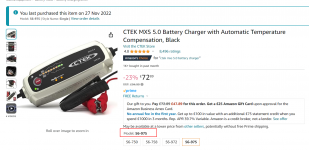

This is the order for the one I got Tom, I'm expecting nothing but left it on anyway, new battery will be here in 3 days via Fed Ex.
