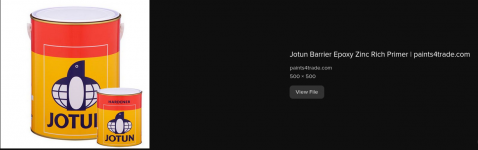

They stopped making proper red led 50 years back, the stuff you buy now is dirt, epoxy 2 pack zink rich is best and self healing if it gets a scratch, this should be overcoated with 2 pack poly or acrylic, today's car paints are water base except the top coat which is a two pack.
I used hammerite on the bare chassis when I first started building a car. From memory, three coats of red lead, and then 8 coats of black hammerite. It's only been about 14 years, but it seems to be holding up well.
Whilst I don't deny you are probably right Trev, we can only work with the tools available at that time
In my case, the paint I mentioned and used, seems to have worked just fine for me.
