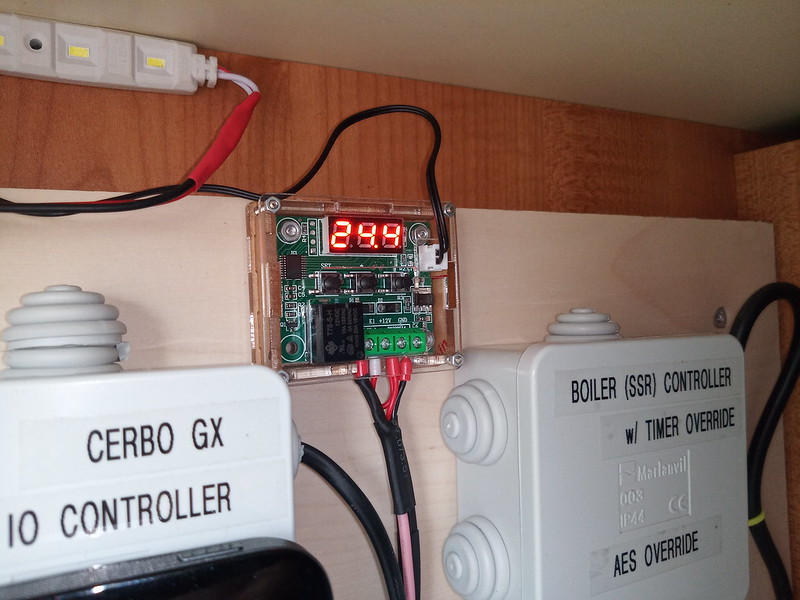

With the three fans mounted in the top vent and blowing air out how and when are they switched on and off? Automatic or manual?
I don't have any photos, but the Fan installation I did for Marchie last week I think is pretty neatWith the three fans mounted in the top vent and blowing air out how and when are they switched on and off? Automatic or manual?
My original 3-way fridge, 2009 Adria Twin, is still working ok (probably jinxed it now!), no fans installed. Freezer although small is impressive, we can get three cooked meat meals in there and just need to add veg. Off to Spain and Portugal for 50 nights in 4 weeks and will try to avoid the hot-hot-hot areas in which case from previous experience the fridge will be fine.
Agreed! And, being anal retentive/OCD, the temperature controller and switch being inside the Van are great! The LEDs are a little bright, but we use the switch to turn the display off at night, so job's a good 'un ...I don't have any photos, but the Fan installation I did for Marchie last week I think is pretty neat
a pair of "UpHere" fans like Greengrass has fitted on the top vent to suck hot air out, fitted to a 3-way switch which lets you have the Fans ON, the Fans OFF, or controlled remotely.
The remote control is a Temperature Controlled Relay, which can be programmed to turn off at whatever temp you want and is a unit same as this one in the photo below (I use this particular one to turn on a fan in my 'electrics locker' door to assist cooling when the Charger/Inverter starts to warm up in use)
Temp Controller by David, on Flickr
the black lead with the white plug is the temp sensor, which in the case of the Fridge fan setup goes into the void at the back of the fridge.
