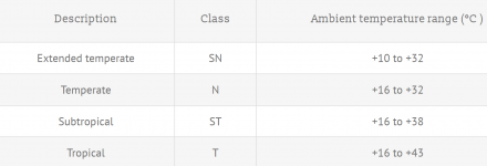

I have to say our van fridge freeze won't work if it below 10 degrees in the van but when we are away it never is its only when it's standing at home .
Best put the pens down when the DT’s kick in.I virtually never turn off the Vans Fridge/Freezer no matter the weather so will have been running at close to 0C ambient for sure sometimes. All that happens is if it gets very cold (ambient), the Fridge/Freezer runs a bit colder.
Not heard of that one Jeff, what brand is yours? Mine works so long as its turned on, temperature doesn't seem to affect it, only voltageNever had a motor go on our home fridge ever
No big deal as its always above 10degees when we are away in it Neil.Weird, that's what mine is as well but never seen it cut out (except when battery dropped too low)
wouldn't suit me have to say.No big deal as its always above 10degees when we are away in it Neil.

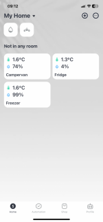

I've got three Bluetooth sensors one in fridge and one in freezer + one in the vanHow do you know it is off Jeff, I only have a single light on the front of mine that's green for on and it went red when I ran battery too low. Is that how you know? If not I suppose mine could have gone off without me knowing?
I haven't got any blue teeth to tell the temperature, just blue lips. Then I know it's cold.I've got three Bluetooth sensors one in fridge and one in freezer + one in the van
Ah, so no indication on the fridge as it comes then? In that case I don't know if mine does the same or not lolI've got three Bluetooth sensors one in fridge and one in freezer + one in the van
It maybe doing it Neil lolAh, so no indication on the fridge as it comes then? In that case I don't know if mine does the same or not lol

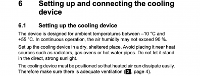

Had a look at the manual and mine should work in ambient down to -10.
