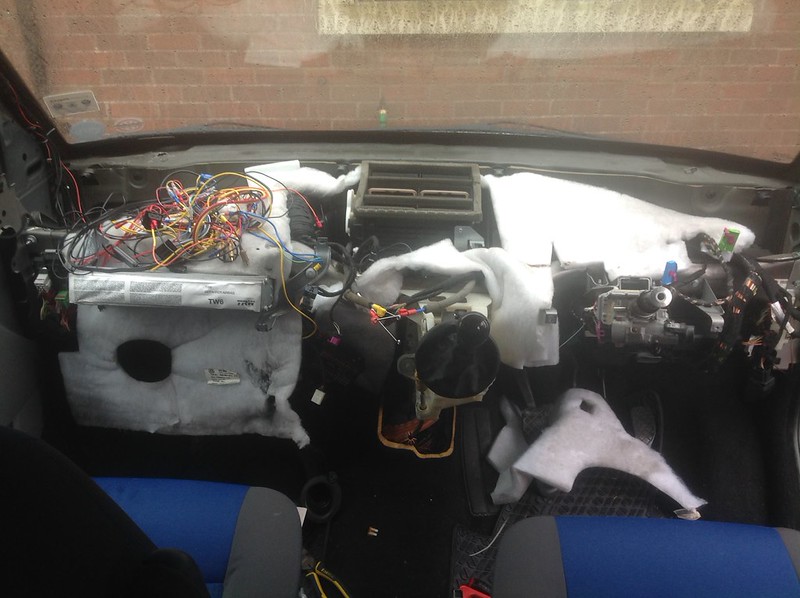

There is nowt the matter with the matrix or the pipes it's the O rings in them that's started to leak.
It was done a few years ago mine is a 2009 relay a new harness and the speed thingy lolololIf not too late check the electrical connector for the fan speed. Both my 08 relay and son's 2010 ducato had started to melt. Easy to do with the dash apart like you had
You must be exhausted…………….watching, Jeffrey!Well that's the pipes fitted onto the new matrix new O rings as well .Looks like it all going back together tomorrow fingers crossed we don't end up with a rattling dash lolol

If your stripping it can I have the seats please worth £25 eachWell we have managed to get the heater unit out and the matrix looks like the O rings on the pipes are leaking View attachment 76151View attachment 76152View attachment 76153
I take it that I am not getting the seats thenJust gave it a good run round and no rattles or squeaks for the dash so jobs a good one lolol
