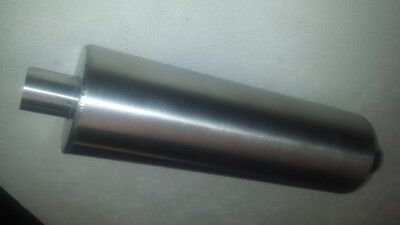

Brilliant heater, the only difference is I have added a silencer on the outside wall as it is a bit noisy otherwise.
