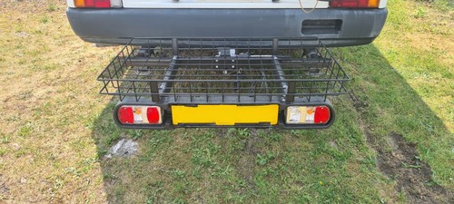

Do you have a towbar?
Seen quite a few disability scooters mounted onto a wire basket that the Germans use for carrying a deer or boar when they’ve been shooting
