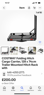

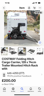

you could use one of these no idea on price or weight but you would be back to lifting this in and out.
That's way too big and isn't what I want Annie.
