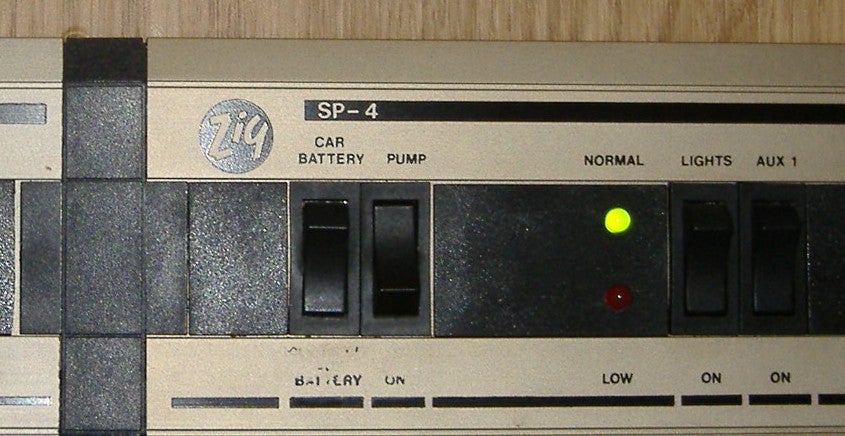

I was thinking about that, I've not had a van newer than 2007, but they have all had a pump switch even my selfbuild. Mine was the SP-4 but essentially the same.

On Googleing the SP4 I found this wot I wrote in 2013 post #9
