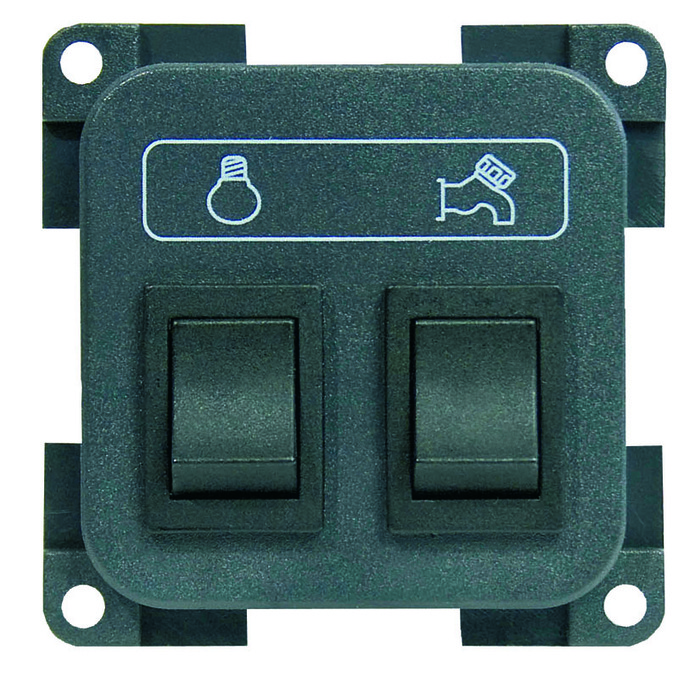

For example, this is a popular [mechanical] pump switch and would be wired between battery (fusebox) and the pump itself
