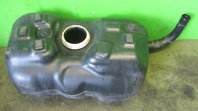

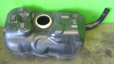

Found a diesel leak from the fuel tank, took it to my local garage for inspection. Appears to be coming from around the top half so needs to be taken out to find the problem. If a new tank is required £900 ouch.
Use a marine tank, cost £70/150 for 2 pipe, a filler connection can be sorted to it with hose as in boats.

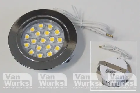

I’ve had a problem with some of my led down lighters not working for a couple of years now work sometimes then flicking and stuff. could not find exact replacements anywhere . And the only way to get the lights out without damaging the veneer on the crap wood they are fitted in is too destroy the light itself. Taking out the glass removing the led fitting then drilling the rivet that holds the metal spring thing that holds them in place. so I decided to replace the lot 20 and that’s just the front.. After I took a few down I started noticing that the connection blocks that were connected were crap and not getting a good tight grip of wire in fact some were slightly open. Pity because that seems to have been the problem all along but you can’t change to the block without destroying the light. I’ve changed all the fancy modern connections too the old school screw type. All working perfect now. The new lights i got from vanwurks they are touchable on of as we’ll.
Hi Wully,
when you said "After I took a few down I started noticing that the connection blocks that were connected were crap and not getting a good tight grip of wire in fact some were slightly open. Pity because that seems to have been the problem all along but you can’t change to the block without destroying the light. I’ve changed all the fancy modern connections too the old school screw type"
you are removing the WAGO connectors and fitting the white screw-down teminals?
Interesting as those wagos are generally much better and many installers are switching to that type universally in both vehicles and buildings. I use them myself rather than the screwdown types.
When you said "some were slightly open", do you mean the lever was not hard down? If so, that is totally normal - the cable is only released from the clamp when the lever is all the way up. The lever moving about loosely when flat does not move the connection clamp at all.
You'll need to very careful with the screw-down ones - lighting wire strands tend to be very thin and it is very easy to get them misligned with the screw-down connectors or even cut through the strands with the screw! (I know I won't be changing back to them :( ). Soldering would be preferable!
Thanks Bill but the ones that were fitted were definitely the problem all I know is that some were not closed right either they were faulty or not fitted correctly which is what I suspect but I wasn’t taking the chance in using them again took my time in fitting the small blocks doubling over wire and checked each light individualy. I’m just happier that I can see they are connected right I taped over each block. I’m no Electricion but I done the best I could with the knowledge I have. 👍
