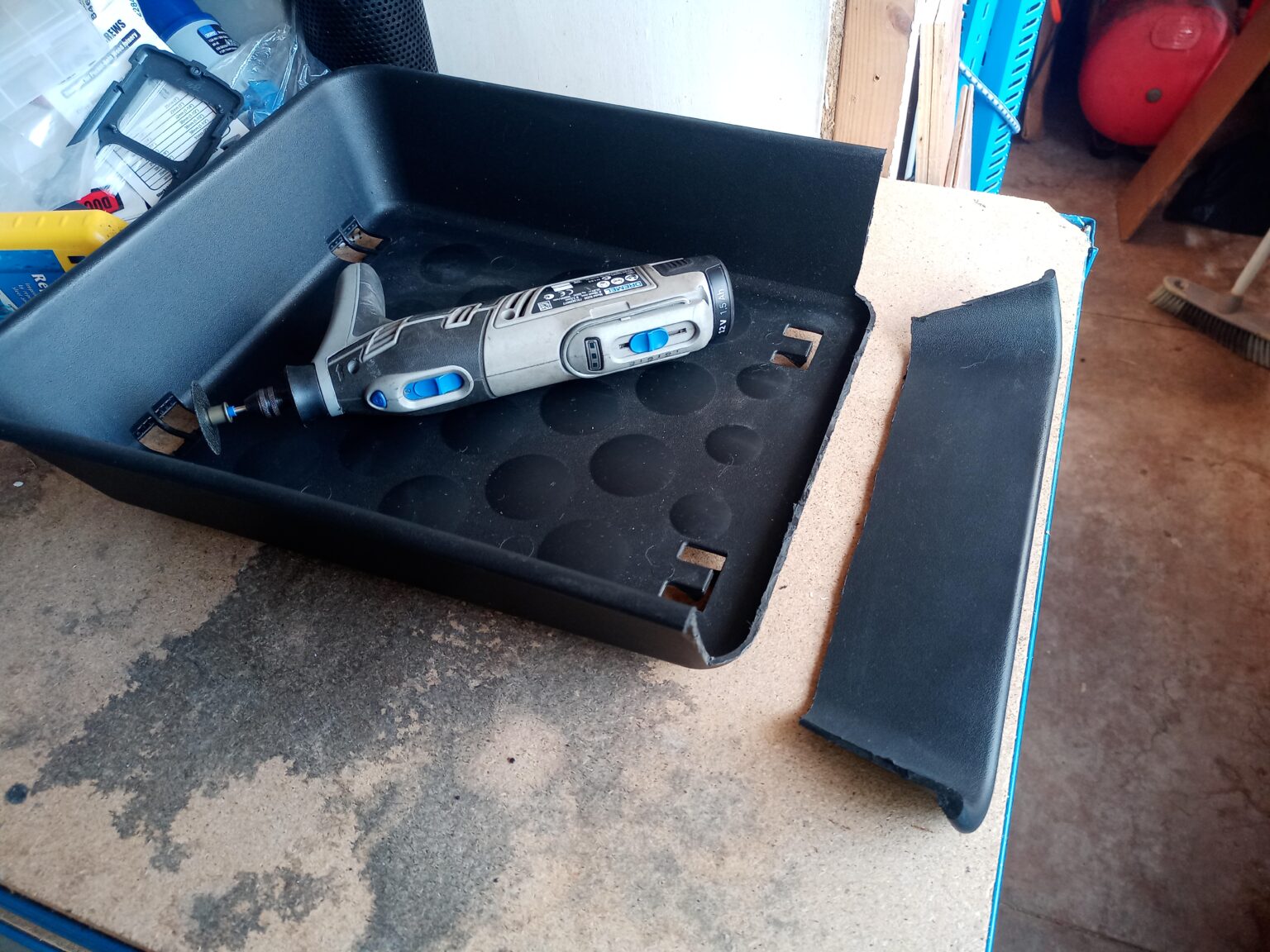

nah, that's to cut off peoples fingertips to stop them posting on the forum.I like the comprehensive tool kit. A Dremel with a metal cutter blade. Is that to break in when you lock yourself out, or to break out when you lock yourself in?![]()

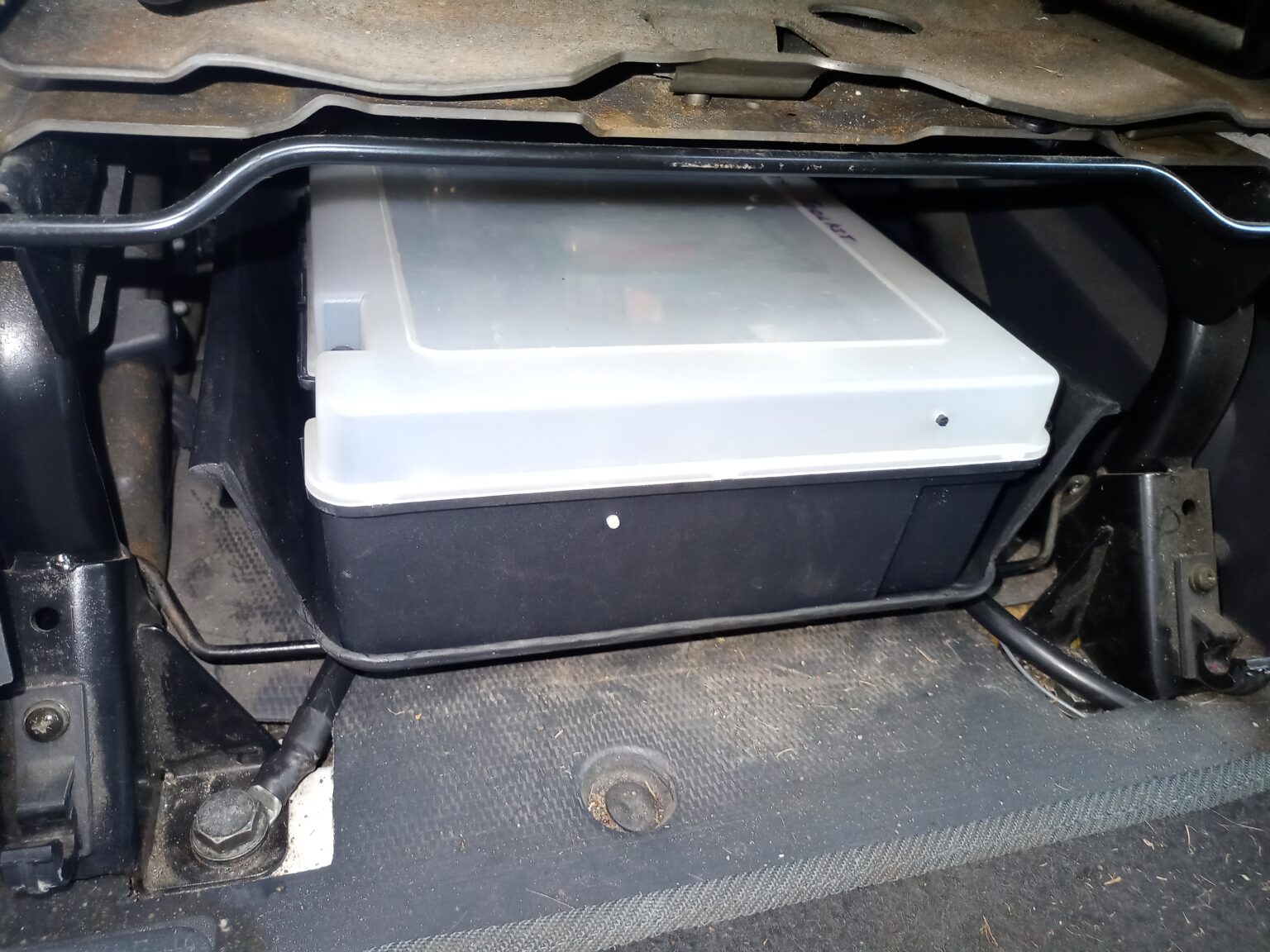

Nice modification David, I think that (or similar) will be going on my to do list.First thing done for quite a while today ... Modified the Drivers underseat tray to allow the storage of a comprehensive toolkit.
Modifying Tray
Tray back in position with Toolkit in position
Detailed write-up if interested .... https://wildebus.com/posts/creating-toolbox-space-in-autotrail/
It is a close thing, but the flap can still stay in place (it would be a pain to have to remove it for sure).Nice modification David, I think that (or similar) will be going on my to do list.
I find that if I keep anything too large under there it can be awkward to get out (but not impossible) because the front access flap doesn’t hinge down fully (I have fettled it so it moves a bit more though). Do you have to unclip the flap to get the toolbox out or has your mod helped with this?
Thanks David, definatley going on my to do listIt is a close thing, but the flap can still stay in place (it would be a pain to have to remove it for sure).

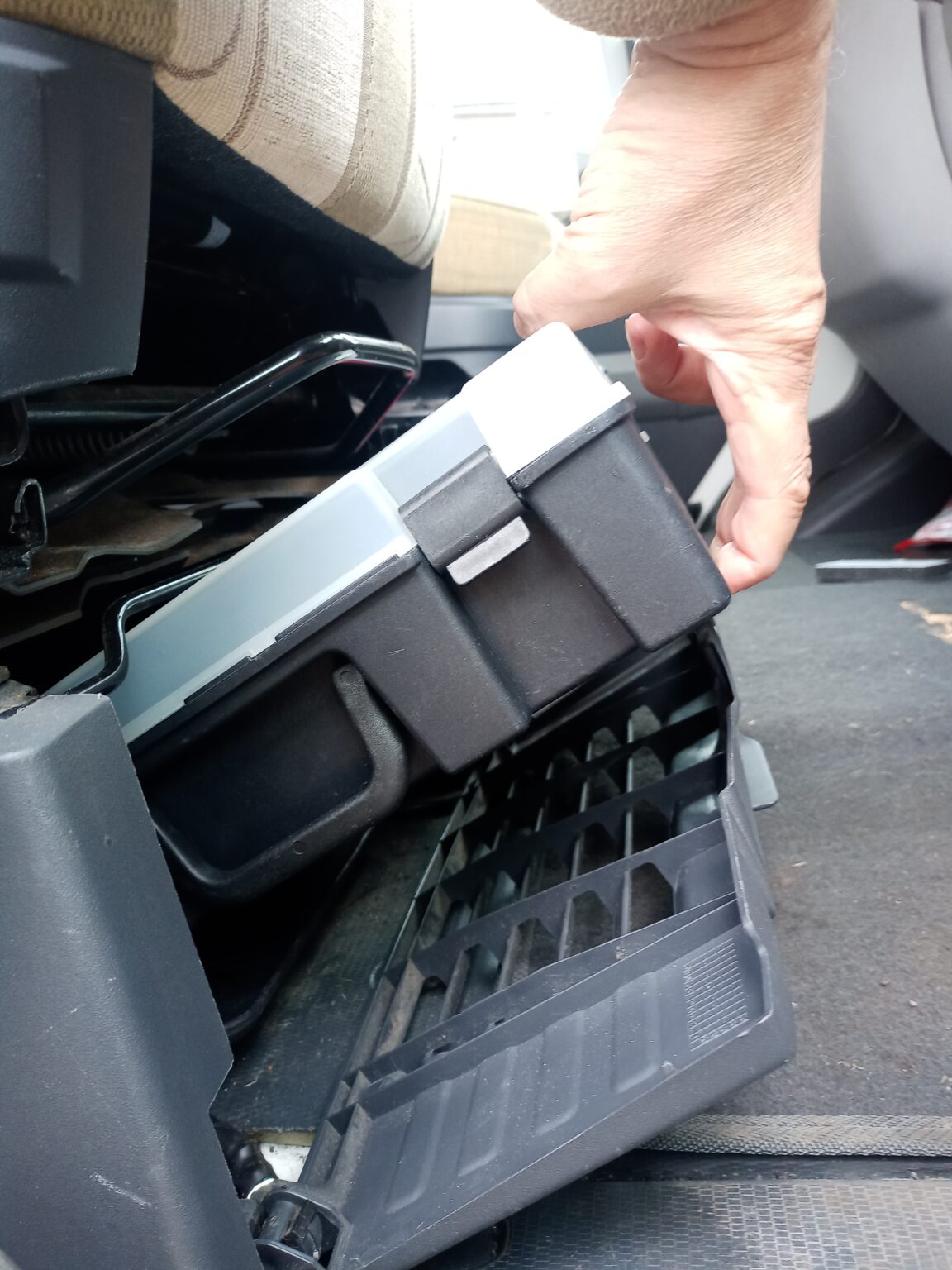

Just went and took a photo to show the clearance ...
It is a pretty tight thing, but doesn't snag up. I would say that if the box you chose fits on the tray and still clears the bars at the top of the base it should clear the opening with the flap dropped but still attached? With this box might have to work out some kind of pull though to make it easier to remove? (The Stanley/DeWalt box would have been MUCH easier to pull out with the front handle. Still an option)
FYI, the box height is 100mm (the length and width can be same as tray) and I would say that is very close to the maximum. maybe 10mm more possible but that could make the extraction more problematical? I was fortunate that both my options I had already happened to be just the right size.
Checking just now, I think I could have cut the front so the lip was around 10-15mm higher which would have secured the box more but I can't see it jumping out with the lip that is in there.
Because he couldn't be bothered to search his garage for the plastic blade and a metal cutter will work very nicely on plastic. QED..........
PS. The tray is made out of plastic so why would there be a metal blade on it?
Re your final sentence, David. I have a full box of sockets, ratchets etc (with an ancient bit of carpet copydexed underneath c. 30 years ago). The socket set is just shoved into the driver's seat tray (elektroblok on passenger side), and has travelled like that for almost 17000 miles without moving, including round the large French and Spanish roundabouts that make the front suspension yaw alarmingly!It is a close thing, but the flap can still stay in place (it would be a pain to have to remove it for sure).
Maybe 'he' knows where to get the right blades and knows just where they are kept?Because he couldn't be bothered to search his garage for the plastic blade and a metal cutter will work very nicely on plastic. QED.
