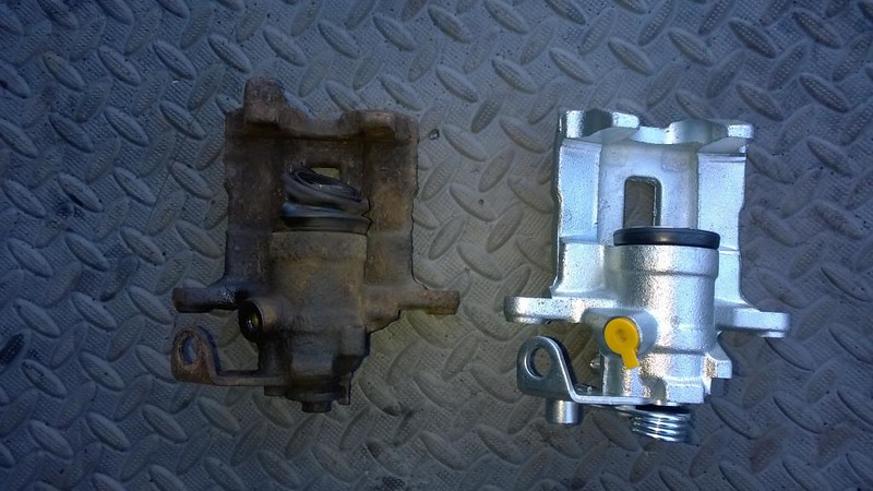

It might be worth pricing up a new brake caliper? I had the same kind of problem with my old VW T4 and I found I could get a pair of new calipers for around the same price as a full brake service kit.Not today but Sunday we got back from our Westcoast & Skye adventure.
Leaving Applecross the van suffered from an intermittent sticky NSF brake so today ordered up new front pads as they were about 60% worn anyway before it started playing up.
Probably strip callipers tommorow to see what issue is but I think its a sticky piston from lack of use as it comes and goes.
Hi Wildbus.It might be worth pricing up a new brake caliper? I had the same kind of problem with my old VW T4 and I found I could get a pair of new calipers for around the same price as a full brake service kit.
You wouldn't expect it to be the case but some parts can be had surprisingly cheaply.

18 years old? treat it to a new caliperHi Wildbus.
Yeah it could be the case of replacing however I will pull it apart 1st and look.
It's done 30k and is 18yrs old and last 3k has been done by me in 10 months so its had a lot of sitting around.
I know the slides are ok as I serviced it when I got it last year so I reckon the piston is a bit gummy and needs removed and cleaned but if its corroded I will get a new / refurbed caliper.
Cheers Alistair.
That's the rear ones in your photo, I wouldn't bother trying to refurb them as theres to many parts that rust and stick.
