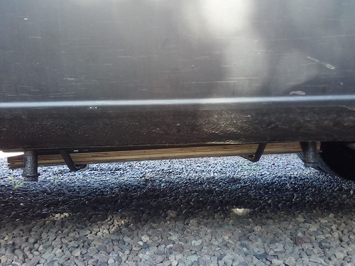

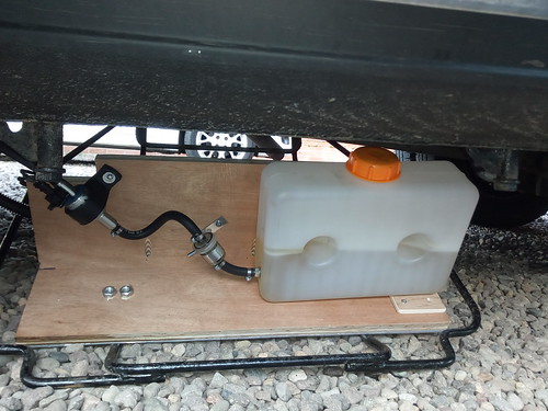

I tee'd in to the Fuel Supply for an existing Webasto Engine Preheater on the VW T5 I installed on one a couple of months ago.
On my own VW LT I used the seperate tank as I wanted to use a cleaner and cheaper fuel and I had a very handy location for the tank
Fuel Station on Carrier
by David, on Flickr
Fuel Station - Raised
by David, on Flickr
