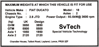

FWIW, I too have an Autotrail (2001 Scout). Out of the factory and as originally plated, it had 3,850 kg MAM and 5,500 kg GTM. When a previous owner downrated it to 3,500 kg, it stayed at 5,500 kg GTM and SVTech restored the original factory ratings (copy of the rating plate, with VIN and certificate No. redacted, attached.)
Is your Scout a Tag Axle? That looks like it would have been 5500 GTW. But the single Axle (implied by the SV tech Plate) version was only 5200 GTW - and a GVW of 3850 like your original Weight and the SvTech plate.
Looks like it may have been incorrectly plated by the converters unless Autotrail changed their specs just after the 2001 Scout was released?
That is quite possible as the numbers I have quoting above are from 2003. And that years data has the Cheyenne 635 (my model) is 3400 GVW and 5200 GTW.
However in 2008 the Cheyenne 635 was 3500 GVW but the GTW had dropped to 4750.
Considering the factory GTW was 6000, I don't really understand why a conversion should lower that GTW TBH. Not sure how it matters if the weight on the chassis is a motorhome box, sacks of plaster or pallettes of bricks?
Looks like it was incorrectly plated by the converters unless Autotrail changed their specs just after the 2001 Scout was released?
FWIW, my Scout is the van in my profile piccy. It's a single-rear-axle Al-ko chassis with a Fiat front end. The Fiat plate gives no weight details. Data on the Al-ko plate is the same as the SvTech certificate.

FWIW, I suspect it could be a combination of factors. For example, even though the SvTech plate claims mine to be a 2.8 JTD, it's actually an idTD as the chassis-cab was built in 2000 and the JTD came in part way through 2001. According to Wikipedia, the 2007 engines changed and the new base engines have less power. As 2008 Autotrails would have been based on chassis built the previous year, I wonder if that had something to do with the reduction in GTM as less power would mean lower mass before restart on a 12% slope was no longer possible. ??
