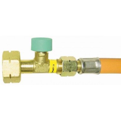

You need to have the crash protection at the bottle so as pigtail hose is also protected to be legal driving with the gas turned on Like this also available for UK propane
This system is compulsory when using drive safe systems (using gas on the move) and automatically cuts the gas supply in the event of an accident
