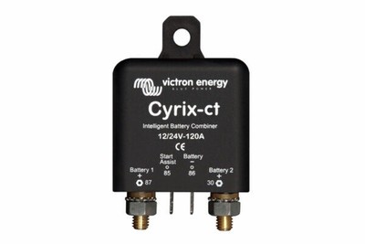

Given that you have an on board charger the Cyrix would also fit the bill but minus the "intelligent" charge cycle. Not a faff to fit either given the positives from each battery will probably be side by side on that on board charger.

For your purposes, the Victron Cyrix-CT is overkill and not the right option IMO for a couple of reasons. You just want to be maintaining the starter battery and you don't need an expensive voltage sensing relay rated at 120A in order to do that. (too pricey, overly big). If you like that concept, you could buy something like a TEC 3M Towing Relay (https://amzn.to/3OJpY98) which is small, basic, but would work. These are used typically in towing electrics to run a fridge in a caravan and inadequately charge a caravans battery, but can be used for your purposes (when it comes to wiring diagrams, your Starter Battery is the "caravan" and your Leisure Battery is the "Car").

Yep, wot David said.I was lucky in that when I was considering such a solution I "won" a WC gift voucher, so it cost me nowt effectively, hence the Cyrix.

The Cyrix's are great battery combiners without a doubt. just overkill for this if buying fresh.
