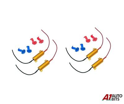

Fitted led rear lights .
The indicators now flash very fast.
The law states between 60 and 120 flashes a minute
How to fool the system that now thinks it has a blown bulb.
Any ideas.
It needs a resistor in the system!

Those look like they'd stop the fast flashing, but they'd also prevent the function of the fast flashingc
The fast flash is supposed to alert you to the fact that one of your indicators isn't working.
With these resistors fitted you'd not be alerted if a lamp fails.
