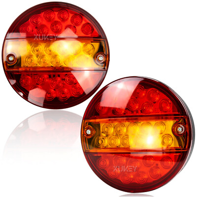

We are it seems talking about two different way to do it, I didn't buy bulbs I bought lights and wired them in.
I was lucky that these were the same size as on the Laika which had earthing issues I did a re-design on what was already there, the LED lights back in 2008 were about £5 each truck stuff is much cheaper than MoHo crap.

Same thing, just laid out in a different pattern, you tend to get what you pay for with LEDs, good no cheap, cheap no good, the ones I got were luckily universal trailer lights and surface mounted on the back so fit almost anything with a round light recess or flat area.

It's not as simple as that, LEDs like to run cool, but squeezing them into a traditional bulb shape allows very restricted heat dissipation,
A custom designed lamp cluster can give the LEDs far better coling, so they should last longer.
Just as well really, because if a 'bulb' fails, you have to replace the whole lamp unit.
If it was an option on my motorhome, I'd be tempted by an LED cluster.
The ones I used do hundreds of thousands of miles with few failures I suppose the plastic they are encased in will act as a heat sink.
As for the LED Bulb type, I've not noticed any heat coming off them, certainly compared to incandescent or Halogen.
Indeed, that's the problem. Because heat isn't coming off, the led modules in the middle get hot (clearly not white hot like a filament gets, but well above ambient) and that shortens their life dramatically.
The ones you use are designed for the job, unlike retrofit LED bulbs.
