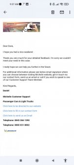

I emailed Michelin tyres and asked if they intended putting the 3 peaks sign on there camping tyres, so that they complied with the new standards for touring in France and Germany in the winter months, or whether I could fit the Agilis cross climates, this was there reply.

I have replied to Michelin's response stating that there camper Tyres no longer meet the criteria for use in the winter months in France and Germany.
I have also pointed out that Continental camper Tyres meet the new standard set by these countries as they display the three peaks symbol that is recognised for winter use.
I have asked if Michelin can recommend another one of there tyres that is suitable to be used on my motorhome that meets the new standards set by these two countries for winter use.
I've said that I and many other camper van owners will have no option but to switch to Continental tyres, if Michelin do not address this dilemma for camper van owners that we are now faced with, many of us use our vehicles in the winter months. See what there response is to that.

This is my reply to Daniel who responded to my first email.
Hi Daniel
Thank you Daniel for your swift reply, I have shared your response with a number of motorhome forums I am on.
I think Michelin are going to loose sales on there camping tyres to there rivals Continental who do make a camping tyre that has the three peaks Symbol on the tyre walls, that is now the standard set by France and Germany for winter months use.
Given the current situation in France and Germany, motorhomes touring these areas in the winter months, which plenty do, will get fined if they are pulled up by the police on your camping tyres as they no longer meet the standards with the M&S symbol, you now have to have the three peak symbol on the sidewalls, Michelin currently dont.
The new legislation no longer recognises the M&S symbol on the Agilis camping tyres as suitable for use in the winter. This has been well documented recently on various motorhome forums.
May I kindly suggest that you send my correspondence to the relevant department, who can perhaps address this problem regarding there camper Tyres for use in winter seasons. If Michelin don't address this, I'm sure sales for this product will dwindle.
Michelin need to offer an alternative winter tyre that can be used on motorhomes and camper vans.
I myself are now considering leaving your brand and fitting the Continental camping tyres tyres that meet the criteria set by France and Germany for use in the Winter.
Given that Michelin is a French company I'm somewhat surprised that they haven't addressed the new Standards that France has set for tyre suitability for use in the winter months.
Kind Regards
David Palmer
I have attached his reply, so it looks like Michelin aren't addressing the problem we are faced with, like Continental have.
