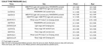

Michelin appear to assume that motorhomes will systematically exceed MAM and advise a very high inflation pressure, even if one attempts to persuade them to base it on actual weights.
I have replaced Continental Vanco Camper tyres with 3PMSF Michelin Agilis Cross-Climate (215/75/R16 116/114R) on the front (driving) wheels of my Hobby, and will be doing the same with the rears when the latter require replacement. I have based my inflation pressures (3.0 bar front, 4.3 bar rear) on those advised by Continental for their tyres, based on the motorhome having been weighed fully loaded (including driver and passenger), each axle separately and both axles simultaneously, when setting off on a tour, and allowing in my calculation for fresh water moving from front to rear as it turns to grey. I would suggest downloading the Continental technical databook https://blobs.continental-tires.com...c3266193/download-technical-databook-data.pdf and having a look at their recommendations (starting around page 86) for similar tyres. Ideally, configure the pdf to display with even pages on the left and succeeding odd page on the right so that you can read across the tables.

I gave Michelin my gvw etc. and the tyres I was fitting ie Agilis and they always say 80psi rears. Conti said nearer to 60psi for theirs. I don’t get a harsh ride on my Burstner Nexxo @4000kg but I do have air suspension on the rear which is lovely at smoothing out bumpy stuff.

The front is based on 1500kg on the front axle and was recommended by Continental's technical department based on that axle loading. Perhaps your front axle has a higher loading or you have greater expertise than Continental's technical department (or both). ;)

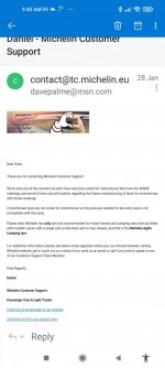

I emailed Michelin tyres and asked if they intended putting the 3 peaks sign on there camping tyres, so that they complied with the new standards for touring in France and Germany in the winter months, or whether I could fit the Agilis cross climates, this was there reply.
