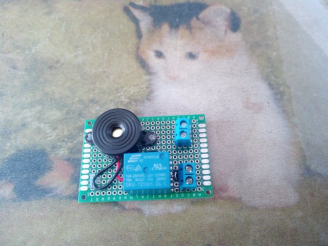

So decided to make my own version ...
Buzz Buzz by David, on Flickr
Relay powered by ignition signal (so only uses power when ignition on) and Relay control signal activated when 240V is detected on the EHU inlet. So ignition off, no buzzer; ignition on, buzzer if EHU plugged in, no buzzer if not.
Now it does work based on power detected on the lead, not just the physical presence of being plugged in, so if the supply is tripped, say, then it will not know to buzz, but that limitation I can live with. Fitted under the lounge seat (where the connections are ) and buzzer still plenty loud enough to be heard (can hear it OUTSIDE the van!)
