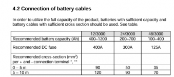

When he comes, I suggest you ask him to fit some suitable cables to the Inverter. The ones you have look way too small to me.Spent the day putting lithium fogstar 460ah in and inverter and b2b cables loads still do .
been lucky most of the old cables of old van fit with a bit of modifications.
Sparky coming friday to fit 240v transfer switch .
The ones on inverter are bigger than they look rated at 200 amps,,the 2 on floor are for b2b which are rated at 85amps only fitting 30amp b2b .When he comes, I suggest you ask him to fit some suitable cables to the Inverter. The ones you have look way too small to me.
Are they 16mm2? I would say for that 2500W Inverter and the distance to the battery, I would go for 50mm2.
You can reuse them
I would be interested in the actual size of the cable. Getting the right cable requires more than just the ampacity rating of the cable.The ones on inverter are bigger than they look rated at 200 amps,,the 2 on floor are for b2b which are rated at 85amps only fitting 30amp b2b .
All worked for 2 years in our old van
We only use small kettle air fryer both 1000w slow cooker. 80w .and Mrs cpac machine .
25mm rated at 200amps but take on board your advice to up grade to 50mm,I would be interested in the actual size of the cable. Getting the right cable requires more than just the ampacity rating of the cable.
And actually some would say I am too low on the 50mm2 cable!25mm rated at 200amps but take on board your advice to up grade to 50mm,
According to my Bosch Automotive Handbook a 70mm C.S.A. cable has a continuous current rating of 245 amps @ 30 degrees C PER METRE.. Rating goes down as ambient temperature rises.I found when I first fitted the inverter I was using 35mm cable but it was getting to warm so I fitted 70mm and everthing if ok now.
PS my invert is less than a mtr away from the batteries.
What does that mean Eric lolololAccording to my Bosch Automotive Handbook a 70mm C.S.A. cable has a continuous current rating of 245 amps @ 30 degrees C PER METRE.. Rating goes down as ambient temperature rises.
Means your cable is probably big enough.What does that mean Eric lololol
HeheheheheMeans your cable is probably big enough.![]()
