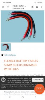

These any goodAnd actually some would say I am too low on the 50mm2 cable!
Take this excert from the Victron Manual for their Inverters - and remember the 12/3000 Inverter is a 2400W output, so actually lower than yours ....
If you follow their recommendation, you would use 90mm2 cable from battery to inverter!
As your inverter and battery are so close, I think you are safe with the 50mm2, but that 25mm2? A wise thing to change. If you were to run the inverter at a high load (which you may be much more tempted to do now you have so much more battery capability), that 25mm2 cable would literally be too hot to handle after a couple of minutes.
