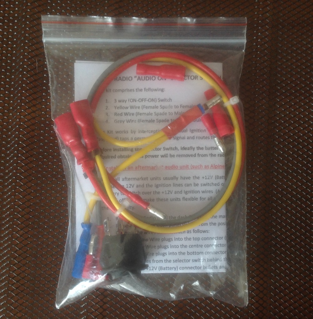

What you can do is fit a little wiring kit which allows you to chose at any time if you wamt the radio to come on with the key, or to come on without the key. I have this on my camper and it is dead handy. Been doing this for years on my last 3 vans.
Simple to do and if you want to lean more, have a read of my thread on the VW Forum where there is an explanation and some Q&A
Radio - adapt to go on with OR without key
Don't you get annoyed when you are parked up and enjoying a wee cuppa (or glass :D) of something when sitting outside or maybe in the back and want to listen to the radio BUT ... you have to leave the keys in the ignition for the radio to work :( So maybe you try and mess around with the wiring...www.vwt4forum.co.uk
PS. It is suitable for any non-canbus controlled radio and not just for VW Vehicles!
