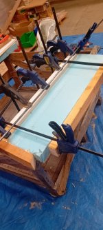

Could I ask out of interest what glue you are using?Onto washroom floor rebuild today.

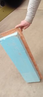

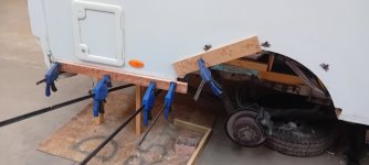

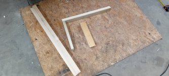

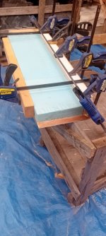

Decided to make most of it in a oner and then fit it so I can glue and screw on bench.

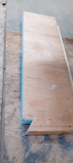

So the floor is made as original but thicker wood/less polystyrene.
Its a sandwich of ply, wood strengening round edges and ply top which linoleum sits on.
Left glue to set,probably fit this afternoon - glue and screw in place and then all new sections will have marine ply bonded and screwed to it, then seam sealer and finished with black bitchumen paint.

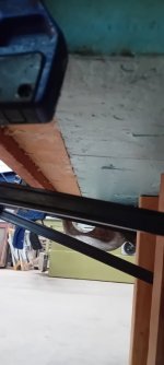

Note : the squint piece of wood is just for clamps to brace against whilst glue dries.![]()
