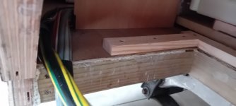

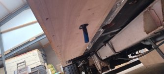

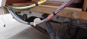

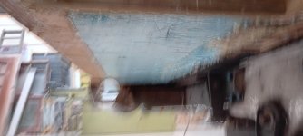

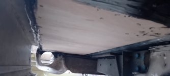

So today I fitted marine ply over all repaired area, sealed and aluminium taped over joins.
Once its all dried I shall paint it with bitumen roofing paint.
Fitted the small side skirt and cleaup long one ready for refit, but as far as woodwork is concerned thats it finished.

Epoxy 2 pack for the wood first then bitumen.
What epoxy 2 pack do you recommend Trev?

It sticks better, i did this for a living, grp and wood.View attachment 75668View attachment 75669
Like I say this application it doesn't. Tried and tested on previous .The bitumen needs to key into marine ply, not sit ontop of primer. I use epoxy primer when painting cars - metal or GRP but not anything else. Marine ply is weird stuff and I've seen various paint peeling from it, however bitumen seems to stick well enough.
